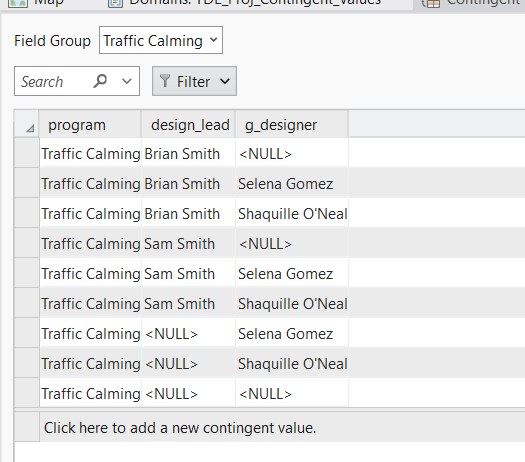

I have then set up the field group, "Traffic Calming" with the program, design_lead and g_designer fields, and set up contingent values on different variations to test:
It seems to work when add a new polygon this way, however when I try to select another program type, the itnerface just looks strange at first glance to me.

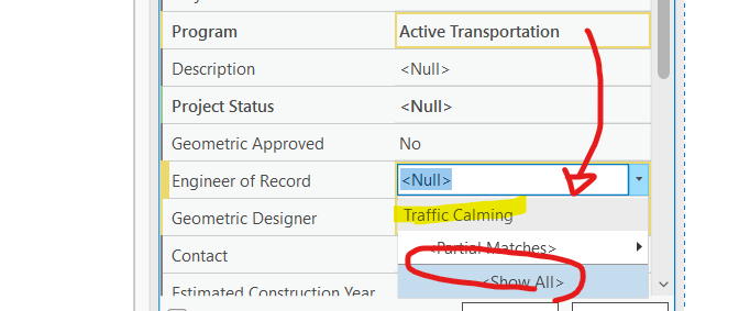

For example, I select Active Transprotation from the domain for Program, but when it comes to choosing the Engineer of Record, the drop down only shows Traffic Calming (Field Group). Can I default it so that it will show the 'Show All' list since I did not select 'Traffic Calming' as the Program? This means every time a user selects another type of program, they'll have to choose '<Show All>' in order to select their Engineer of Record and Geometric Designer?
Would this be the correct workflow, or would there be a better one to accomplish the workflow indicated while still ensuring if a user selects another program type (i.e. Active Transportation), that it isn't confusing for the end user?
JenniferCadkin
The 'Traffic Calming' string you highlighted is the name of the Field Group.  If you add a row to the field group:
program = Active Transportation
design_lead = ANY
g_designer = ANY
does this help?  I believe what is happening is that you did not add Active Transportation to the field group.
