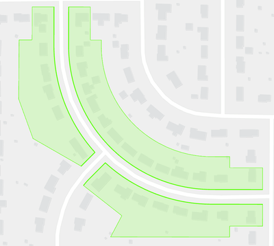

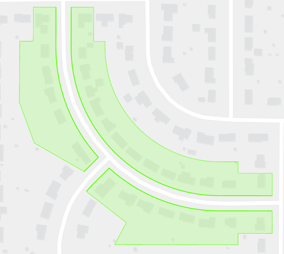

After a merge, my polygons look like this (made up of merged parcels)

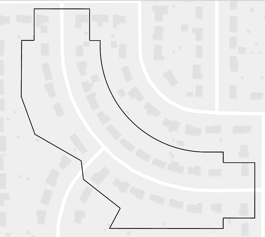

I am hoping to find a tool that will then update the same (feature class) polygon and its attributes to look like this:
