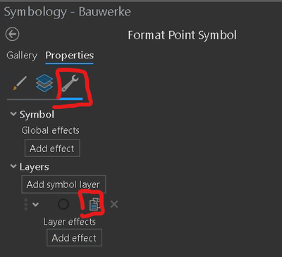

How can I create a concentric ring symbology in ArcGIS?

Go into the symbology pane and create a ring symbol.
Switch to the Structure tab and duplicate the symbol layer.
Switch back and change the attributes of the duplicated layer.
Repeat as needed.
Have a great day!
Johannes

GISLearner
Thank you!! Exactly what I was looking for!
