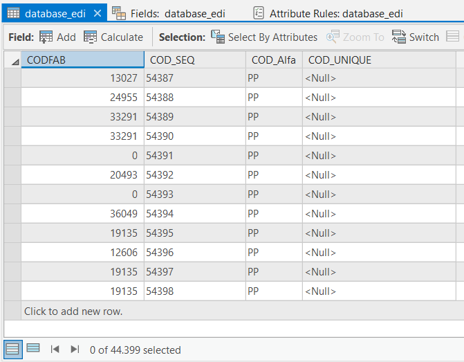

So, my feature has:
cod_fab  that is already compilate
cod_seq  for what I do  calculate field –> Sequential number from 10.000 interval 1
cod_alfa   with two letters, the same for all records (calculate field )
cod_unique concatenate field (cod_fab + cod_alfa + cod_seq)
The attribute rules that I want to create for fields above is :
a. If  cod_fab is null or zero return 00000
b. Nextsequencevalue, in cod_seq, from 54.398
c. Compilate PP in cod_alfa field
d. Concatenate in cod_unique: cod_fab (its numeric field - 5 digits), cod_alfa(PP) e cod_seq
The result should be something like that 36049PP54394
My problems are:
1-create and run all these attribute rule
2- Implement all these attribute rules in feature that has more than 44.400 geometries
3 - Some records have cod_fab zero, so I try to put 00000 in cod_unique to complete the field.
Yours advices will be very very welcome !!

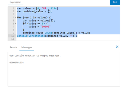

I tinkered around a bit in the arcade ' playground '  and got the following code working:
var values = [0, 'PP', 1234]
var combined_value = [];
for (var i in values) {
    var value = values[i];
    if (value == 0) {
        value = "00000"
    combined_value[Count(combined_value)] = value}
Console(Concatenate(combined_value, ""));
The Console() function prints the value of the concatenated_value:
Hopefully this helps a bit.
