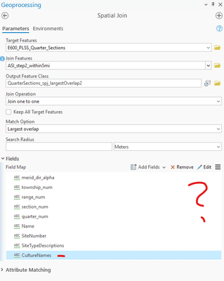

Hi @KoryKramer !

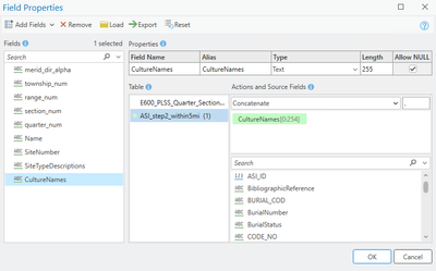

I'm spatially joining polygons to polygon. This is what I'm trying to do but I'm in Pro 3.5.7, what happened to the Merge rule Join?
I'm lost now. If I click on Edit I get Action Concatenate but when I run it, it doesn't concatenate anything, it gives me the value of the first polygon (of many) in the target polygon. I would like the attribute table to have all of the CultureNames values of the many polygons within the target polygon. I tried reading the help docs and they don't say how to do this.
