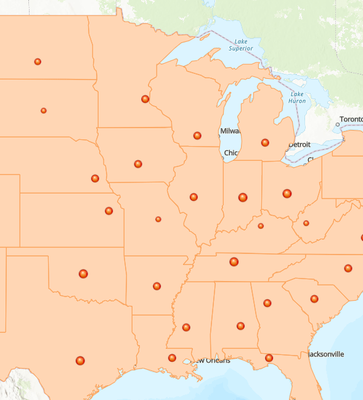

To make something like this work, it's best if the layers share an attribute. Consider this dashboard map:

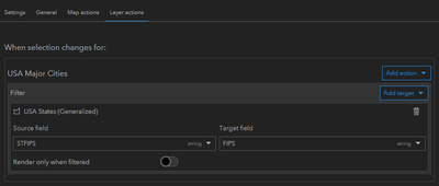

In the map's settings, I can add an action to filter the states when the capital city is selected, because they share a FIPS code in their attribute tables.
