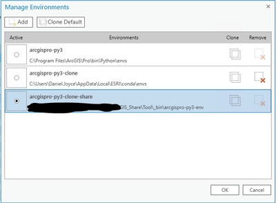

I've successfully cloned the default Python instance to a network file share folder.  It took quite a while to clone, which was expected due to network latency.
Currently installing the boto3 and ReportLab modules into this environment.
Haven't yet tested if other users can select this environment.
Also haven't tested this setup to see if there is a significant impact on performance.  I'll do some benchmarking and report back.
*** UPDATE ***
Installing the boto3 and ReportLab modules was successful.
Adding the shared Python environment using a UNC path looked like it worked, but when running my test script, it didn't appear to do anything.  I think I read somewhere else that Python environments don't like UNC paths.
I then mapped the network location with a drive letter and re-added the shared environment.
This fixed the issue and my script ran as expected.
