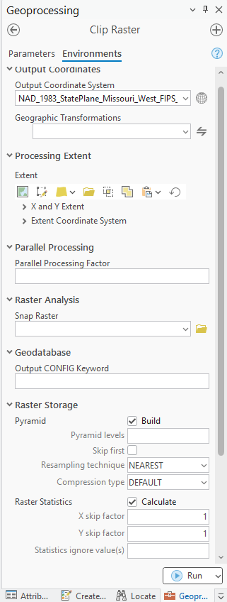

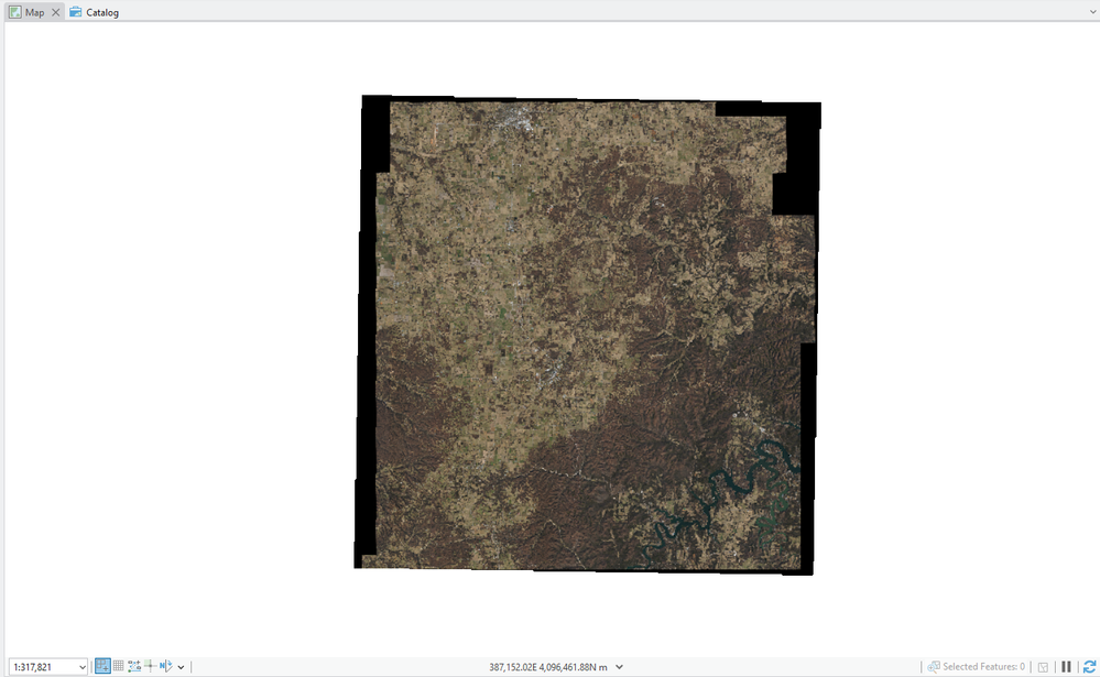

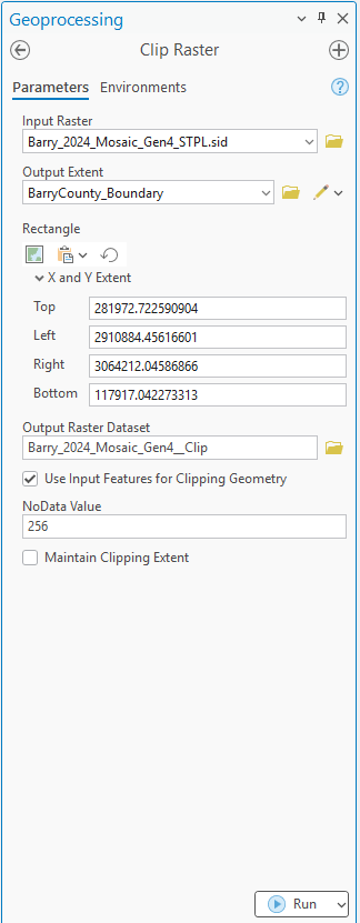

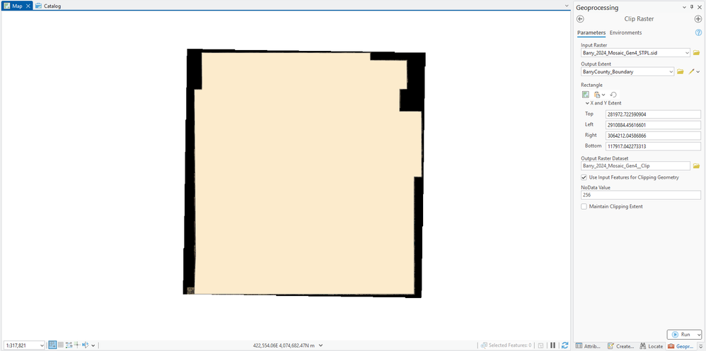

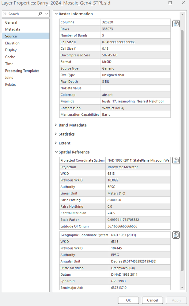

I am newer to ArcGIS Pro and do not normally do any editing or clipping to raster data.  However, we recently received raster imagery for our county.  We need to overlay a surrounding county to our imagery but both our county and the surrounding county has black around the county border in the imagery.  I have been trying to clip the actual aerial portions are the raster using a polygon that I quickly made so it would clip the aerial out of the black border.  When the clip finishes, it is 390GB with only the color white and no imagery.  I have tried going to the Raster Layer tab and clicking Band Combination and trying the Color Infrared and Natural Color options but it does not show anything either.
The original raster is a MrSid format, when that clipping attempt result was white, I converted the format to .tif.  The tif clipping is also white.
I have also tried changing the NoData to 256 and 9999 with no changes.
The Aerial data is large, the MrSid is 96GB and the Tiff is 500GB.
I have attached screenshots of the map, clip raster settings, and raster properties.
Any help would be very appreciated!
Polygon to clip toPolygon to clip toAerial ImageryAerial ImageryMr.Sid PropertiesMr.Sid PropertiesTiff PropertiesTiff PropertiesClip Raster ParametersClip Raster ParametersClip Raster Environments1Clip Raster Environments1Clip Raster Environments2Clip Raster Environments2

I would just try unchecking the second last parameter to avoid any changes to the pixel type as indicated in the help, and specify the nodata value used by the input raster
Clipping a raster shouldn't take that long unless some background processing is required to realign cell position and/or output pixel type.
Get a simple rectangular clip to work first, then worry about an non-rectangular clip extent.

For the projection, the polygon, Mr.Sid and Tiff are all NAD 1983 (2011) StatePlane Missouri West FIPS 2403 (Meters).  I have also tried running the process without specifying a projection.

Simplifying the polygon and changing the symbology to not show the black border worked, thank you!
