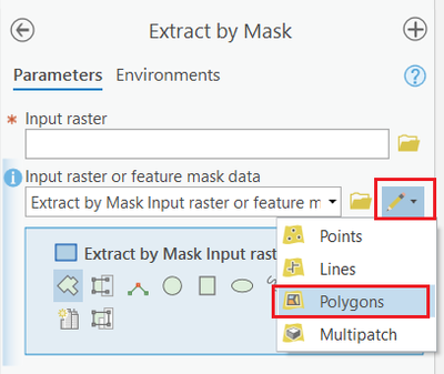

If you want to clip raster by drawing a graphics, you could use Extract by Mask (Spatial Analyst)—ArcGIS Pro | Documentation.
