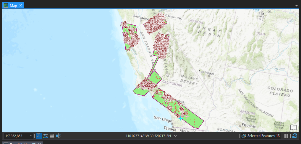

Hello, I am wondering if anyone else has had an issue with the Clip Tool including JUST ONE point from outside their clip boundary area? (I am using ArcPro 2.6.1) I clipped some point features with a shapefile, and out of the 1,549 points that were produced, one is about 1.5 km away from the boundary edge of the shapefile I used to clip the points.
Here is a view of my shapefile and the 1,579 points I clipped:

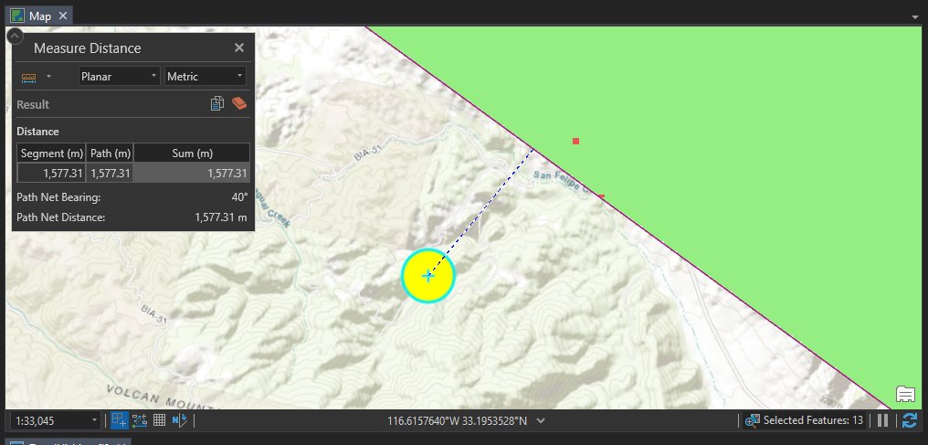

Here is a view of the ONE POINT that is outside of the clip boundary:

I ran the Geodetic Densify (I'm not very versed in the differences between the different Geodetic Types), but It looks like non of the Geodetic Densify results (GreatElliptic, Loxodrome, Normal Selection, Geodesic) had that point within them. Only the original bounding rectangle has that one point in it:
A closer view of the point in comparison to the "flights" and "flights_GeodeticDensify_Loxodrome" boundary lines, with "flights" being the outermost bounding rectangle:
