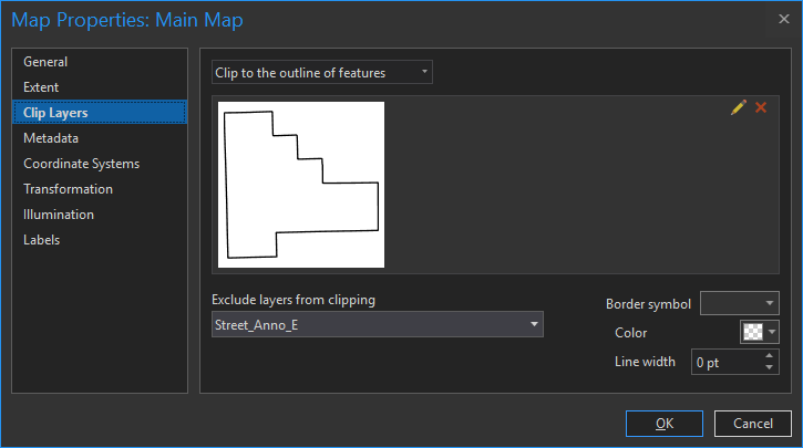

You can Clip Layers in ArcPro just like in ArcMap. But I think it's even enhanced as I don't remember a dropdown that can exclude layers from being clipped-- pretty nice.
All you do is left click the map frame on the Layout tab --> Properties --> Clip Layers

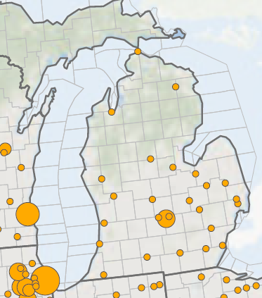

I'm using ArcGIS Pro 2.3.3 and I still encounter the error in which the clipping is not honored in the export. In the following example, the US state boundaries are clipping the county boundaries. The image on the left is from ArcGIS Pro (showing the clip) and the image on the right is from the export (not showing the clip). So is 2.4 supposed to fix this discrepancy? Thanks for any info you can provide!
Map in ArcGIS Pro
