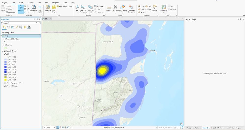

Hello,
I am a GIS student who is still fairly new to ArcGIS Pro. I'm making a map of bird distribution and utilizing the heat map feature. I have added a layer of crowdsourced reports of a species of bird that's using x,y data; I assume this is a point layer.

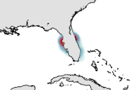

My problem is that I want the extraneous parts of the heat map that is outside the border of a state/country border to be clipped or hidden. The blue portions of my heat map in the attached image 1 are what trying to remove or mask/clip. I've tried a number of solutions but none seem to give me my desired result. The masking button under Feature Layer tab gets close to what I want, but it is inverted (See image 2). Essentially, I want the heat map to be limited to land, as the heat map "bleeds" outside the country boundary.

One option to consider is to go to your Map Properties-Clip Layers and choose Clip to an Outline.  From there, choose the polygon layer that will be used as the outline.  You can optionally exclude layers from clipping in this User Interface as well.

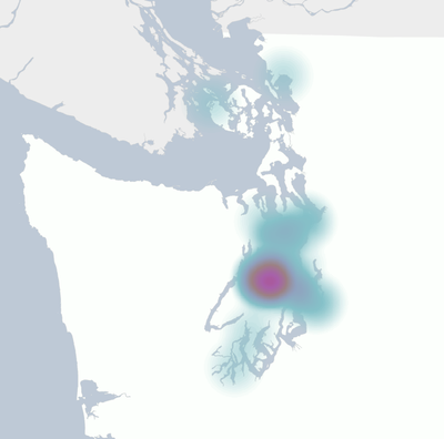

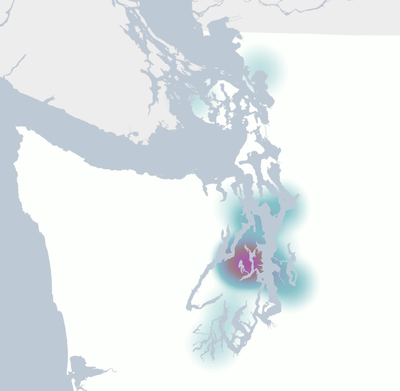

This isn't the most beautiful answer, but I just use a marine waters data layer as a masking extent. Something like this:
And mask using the Marine Waters of Washington State:
