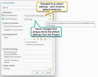

In Model Builder, I want to clear custom Workspace variables in the Environment settings.
To be clear, I want a model to run using whatever the default database/workspace of a given user is.
The below screenshot shows a brand new model with a simple string variable in it) where I have Saved it without having touched the Environments. I then opened it and confirmed the pathways were pointing to my default gdb (as shown in the tool tip for Scratch Workspace).
I then got a colleague to open the model and the Environments, and both pathways had changed to show her default geodatabase. I got her to manually enter a different pathway for the Current Workspace (%userprofile%\scratch.gdb) and save the model. I then reopened it and can see the updated Current Workspace pathway, but the Scratch one (left unchanged by my colleague) still reverted to my default gdb.
How do I get the pathway that has been customised to go back to defaulting to the default gdb of any given user? Simply selecting the pathway and deleting it doesn't work - this just results in the current default in my project being put there and remaining hardwired for other users.
