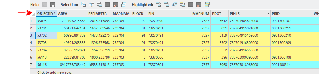

Nope it's still there in 3.5.1, just checked. this is where i clicked

Sorry, reading your post again, to clear selection within a selection you have to click Clear under Highlighted. Top left corner will clear the entire selection.
