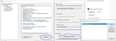

What happens if you remove all the Portal/AGOL connections from ArcGIS Pro, also remove any Portal connections from ArcGIS Administrator (except https://www.arcgis.com/).
Restart ArcGIS Pro. Add the connections again.
