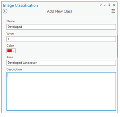

Hello,
I am currently Classifying Pixels to one class. How would I able to make the tool label multiple classes with different training labels? When I input two different training data for training, it classifies them as the same class when I run the model.

@ChelsGIS please see the attached pdf for detailed steps for a pixel classification workflow (it will be available at v3.2 release). but this is how do you create multiple classes
    1. Right-click the schema you created, and choose Add New Class.PavanYadav_0-1695417921901.png
      you will have something like the following.
      I hope this helps.
