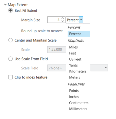

  • extentOptions
  • marginType
  • marginUnits
  • margin
 The Usual GUI Spatial Map Series' Tool clearly reflects the CIM Options for marginType (Percent, MapUnits, or PageUnits).  But any attempt on my part to specify anything other than Percent in the CIM just gets ignored.

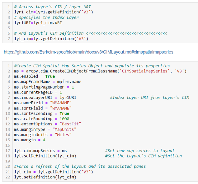

    Attempting This (4-mile margin according to the MapUnits):

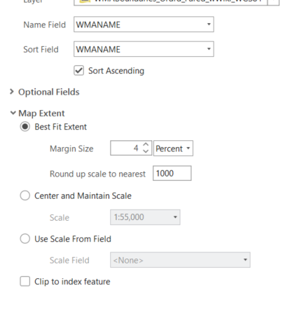

 Results in this:
A 4 Percent Margin.

I found it.  Wish I could delete the question now.  It was my specified wkid of the projection, which was not correct at all.  Me intending to use "Miles" requires the use of:
'uwkid': 9093
 apparently.  I feel like this one came out of left field, and I don't know where exactly it comes from: LinearUnitId (arcgis.com)
