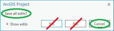

If I try to close ArcGIS Pro with unsaved edits, and choose to save edits when prompted, then the edits don’t actually get saved.
  • Clicking yes/no/cancel in the subsequent save Pro project dialog doesn’t help; the edits get discarded regardless.
  • I think the workaround is to save manually before closing ArcGIS Pro, which is a good practice anyway.
  • If you happen to accidently try to close Pro with unsaved edits, then I would suggest clicking CANCEL, not YES, in the save edits dialog.
  • And then manually save your edits.
