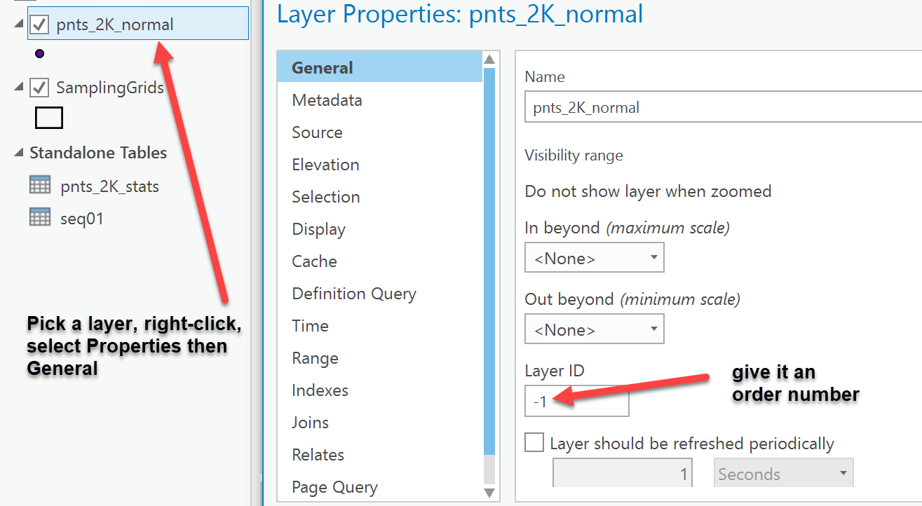

but maybe if you set it up first and are using the same names, it might keep the order
I totally haven't tried this but I read about it here....
Introduction to sharing web layers—ArcGIS Pro | ArcGIS Desktop
Preserve layer and table IDs
then
But I don't share maps, but might have to

MarkJones7
you sir are an absolute GENIUS! Thank you! That worked perfectly!!
