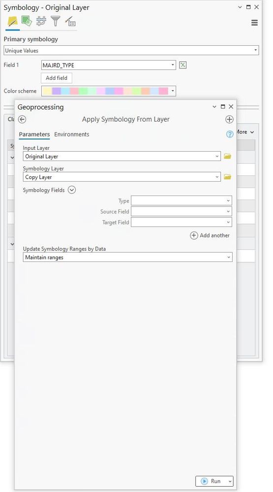

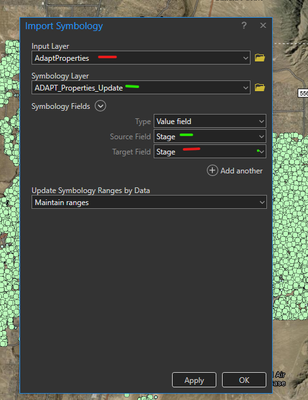

I think the way you want to approach this is to copy/duplicate your layer - name it slightly differently if you need to just to keep track of them, then click over to the 'feature layer' menu in your ribbon, and click on the import symbology button (see the 1st screen shot below). This will bring up the dialogue in the 2nd screen shot where you specify the layer you are symbolizing (red mark), the one you are pulling symbols from (green marks) and the respective fields you are working with in each. That should apply the symbols from the first to the second based on the updated field values.

hah, you know, I never knew you could bring that up from the symbology dialogue, sheesh. neat trick, thanks for pointing it out.

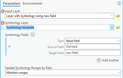

I haven't tested it with symbology setup involving multiple fields or Arcade expression, but if there is only one field  (Field 1) involved in your symbology and you want switch it to another single field, you can
1) make a copy of the layer with the right symbology as symbology template and
2) import symbology to my working layer from Symbology template using Apply Symbology from Layer.
In Apply Symbology From Layer, you can choose a different field as a target field. If new field and old field has the same data type, this should works.
In this way, you can avoid getting your symbology reset because your are not resetting anything. Please note that if your data is numerical and data in your new field has a wider range, you might want to decide whether you'd like to maintain ranges or update range. I personally prefer choosing maintain ranges and manually fix range in histogram view to make sure your symbology definition covers everything. I strike previous sentences because I realized you mentioned that you symbolized using unique value (symbolized by category) and the data in two fields are identical. Those notes only apply for layer symbolized by quantities with different data between two fields.
