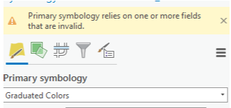

In a new twist, I now have an SDE layer displaying with the symbology set for an entirely different layer that isn't even in the SDE file location.  It then won't display any of the features because the symbology is tied to a field that doesn't exist.
How did this happen??  I'm using Pro 3.0.  I haven't been able to load the patches yet.
Robert_LeClair
Esri Esteemed Contributor
Amy - one thing I see in the internals about this error message has to do with joins.  Resolution is to remove all joins, symbolize the feature class, add joins and error message goes away.  Do you have joins on the feature class by chance?
AmyKuhel1
The error message in the screen capture isn't really the problem, if that is what you are getting at.  The problem is that the symbology that is being displayed is from separate layer not even in the SDE.
ie: I am trying to open NLD.rehab which should be a single symbol feature and lives in Oracle using an SDE.  It is opening with the symbology of a different layer (levee rehab density) that is on a map directory, not in SDE.
The error message was just to demonstrate that it is built for a field that isn't in this layer.
