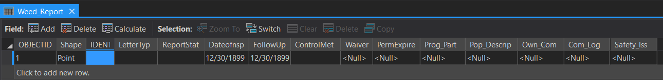

My attribute table of the point feature class showing the one point value to get the data to populate in the app

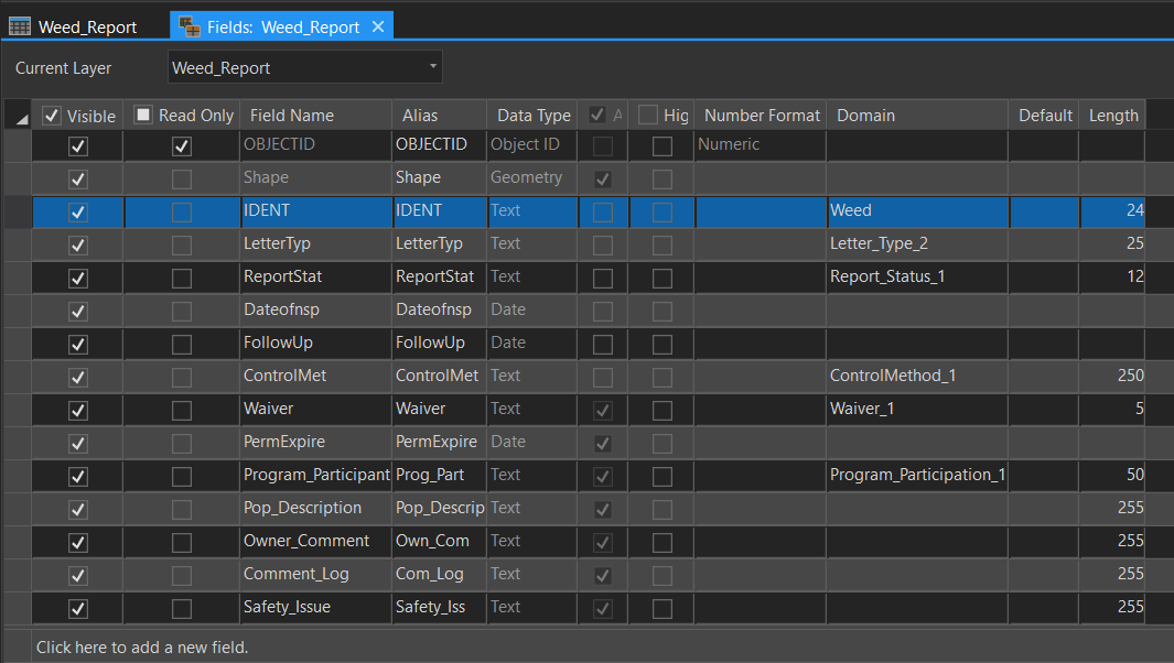

The field with the coded value domain

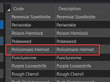

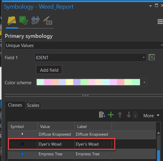

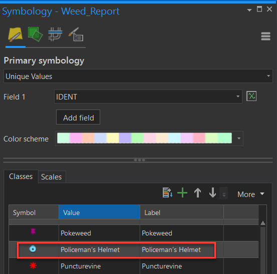

I just removed the apostrophe from Dyer's Woad and Policeman's Helmet, then I clicked save.
When I open the symbology the apostrophe's are still there. I can remove the apostrophe from the Label but not from the Value.
I don't want to click regenerate all labels because I will lose my symbology. Incidentally I have had to do this before and had to resymbolize everything so I think they will keep wanting to add and change values and I'll have to do this again.
They are familiar with the symbols and want them to be the same and not change.

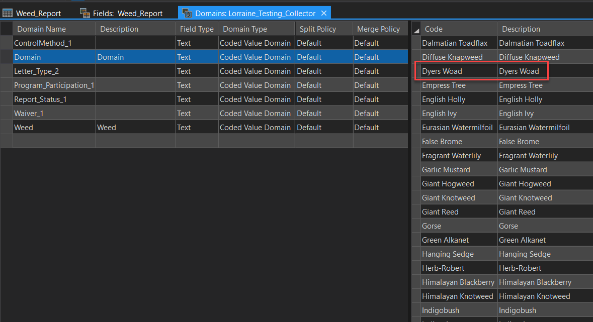

Your pictures show IDENT having the "weed" domain assigned, but, your domains pic shows the values in a domain named "Domain"?  So, need to make sure you are changing in the correct domain.
Once you have a new value in the data, you can right click on the Value in the symbology properties and select remove.  that will remove the old value with the apostrophe.
Then, the green plus sign will let you pick individual values to add to the symbology, and you will only have to re-select the symbol for that "new" value.

You're right. I forgot that "Domain" was my first attempt and I ended up using the domain called "Weed". As soon as I removed the apostrophes from the weed domain the text in the symbology updated automatically so I didn't have to change the symbols.
