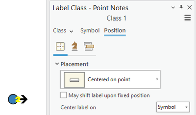

ArcGIS Pro version 3.1, just released, introduces a new point labeling setting to control whether the label is centered on the symbol or on the point feature's geometry.
Centered on symbol:
Centered on geometry:

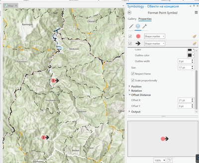

KalinaStoycheva
did you set your label position to be centered on point? If yes, then the problem is from the symbol. I tried to reconstruct the symbol in Pro and it's working for me, so check to see if the circle is offset or not. It looks like once you load the symbol the circle is offset to the left and the arrow to the right instead of only the arrow, you can check to make sure from the symbol properties.  In the image below is my reconstruction where only the arrow has an offset and there is no problem.
