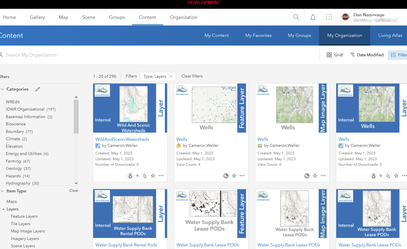

Proof that we have items in our portal and that we can see them in a browser:

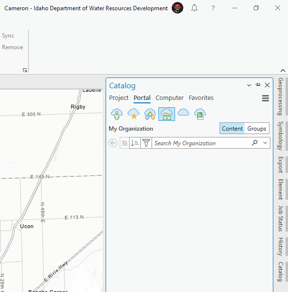

Nothing in the catalog when we view our org's items:

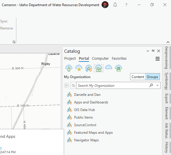

But we can see groups!
