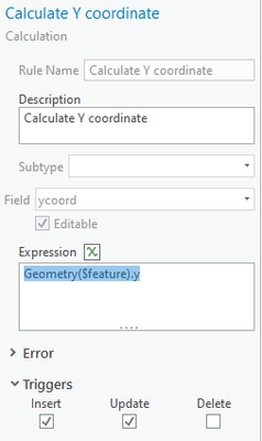

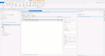

To add to Robert's comment about using Calculate Geometry, another geoprocessing tool that will allow you to calculate both x and y fields at the same time is Add Geometry Attributes (Data Management)—ArcGIS Pro | Documentation  .  However, the drawback is that the calculation is done once and if the point is edited, you would need to calculate those attributes again.  From the help topic:"The values in these fields are not automatically recalculated after edits. If you edit the features, you'll need to run this tool again to update the field values."
So you might want to look into setting up Attribute Rules on your x and y fields so that they are always maintained on insert and update.
Quick points about using attribute rules:
You'll need a standard or advanced license.
You'll need to add a global id field.
The Arcade expressions I used were:
Geometry($feature).x
Geometry($feature).y
It looks like this:
Hope this helps!
EDIT: Wrote this blog that outlines the process: Get to the Point: Automatically maintain x,y,z attribute values with ArcGIS Pro and attribute rules
