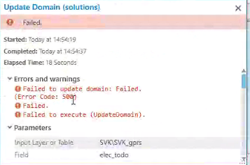

Now we want to do a new update, but it throws this error, when running the tool after we added a new coded value:
Any ideas on how to update domains to a Survey123 hosted feature service on Portal 10.6?
