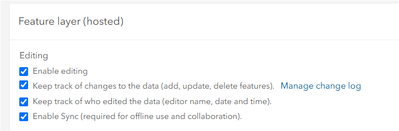

I created a dash board with 4 layers. I enabled editing for one of the hosted layers as described here: https://www.esri.com/arcgis-blog/products/ops-dashboard/real-time/updating-attributes-in-dashboards/
specifically under the heading "Configure a layer’s capabilities".

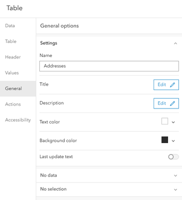

When i go into the General settings for the table I want to allow editing on, I am not presented with the toggle to allow editing of the table.
What am I missing?

DanielFox1
Hi @FlightDeck
I was playing around with this and initially I didn't the setting with just the enable editing checked so I allowed the other options to be checked and it enabled the editing option in the dashboard
Not exactly sure what setting opened it but I hope this is some help
My thought is it could be the keeping track of who edited the data.
FlightDeck
Unfortunately, even after applying the change the option still isn't appearing...

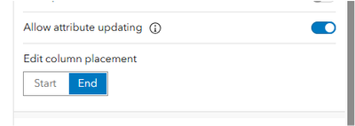

I am having the exact same issue.   Working with Enterprise 11.4, when I create a Dashboard, even with all editing boxes checked on my feature layers, I do not have the option to 'Allow attribute updating'.
FlightDeck
@Charlie_Kaufman If memory serves, I believe I submitted a ticket to ESRI support and was told 11.5 was the first version to actually support this type of editing.
