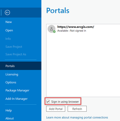

Cannot Sign into ArcPro Licensing Portal Connection without signing in using web browser. I was previously able to directly input my credentials using the Portal Manager in the Upper Right corner of Pro. One day I changed a setting somewhere and now I can only sign into my Licensing Portal connection through a web browser that pops up whenever I need to reestablish my License Connection.
screenshot is of the ArcPro Redirect to browser
This is very annoying is there any way I can go back to making my connection solely within Pro?

@Robert_LeClair's solution probably works, but there's an easier way to do this from the application. On the Portal's tab, there's a Sign in using browser option. If you uncheck it, you won't be redirected to a web browser next time you sign in.

Frank_SA
Ha, I did the Registery Refresh but yep I found the check box, settings are tucked away sometimes
The check box would have been easier
TY!
