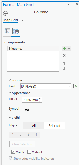

Hello, I'm working with a custom grid and I want to display labels on only one edge.
As you can see on the screenshot, the selection tool is unavailable, when I click on "Selected" that cause arcgis to freeze for a moment and then it switch back to "All". It works perfectly for the ticks, I have no problem to use the "selected" option in this case.
Any tips that could solve the problem ?
Thanks.

AubriOtis
That looks like it might be a bug. What version of Pro are you using?
Cheers,
Aubri
MartinJacquet
Yeah I found another post where the same issue was reported right after posting mine, it was indeed suggested that it's probably a bug. I contacted the support.
I'm working with 2.8.3

MartinJacquet
Update : the bug doesn't occurs when I set my grid parameters before creating the map series.
