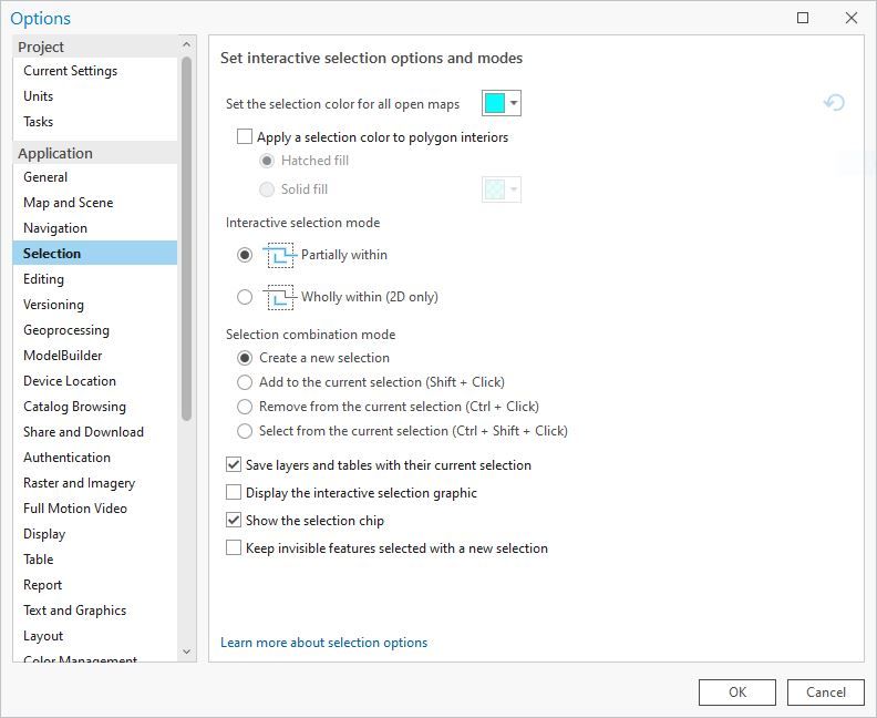

Hi Tim - well darn.  I was hoping that would resolve the issue.  Next up - what are your Selection options from the Project->Options tab->Application-> Selection tab?  My are below:

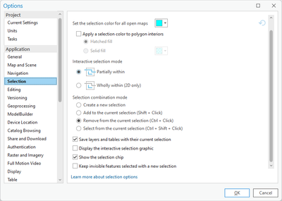

TimothyFratta
Hi Robert,
The only difference I see is the remove from the current selection. Would that be the reason???
Tim
TimothyFratta
Bingo! That's it :-)))))
