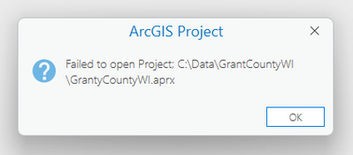

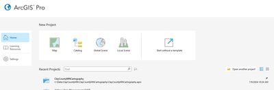

I'm also unable to open a project from under the "Recent Projects" list on the Home screen. I get the following sort of message.
Near the Recent Projects list there's a button to "Open another project". This method gives me a similar error

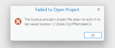

In fact, I've discovered another one of the methods does not work properly for me: When I just launch Pro (without initially clicking an aprx)... it shows me the list of "Recent Projects". And when I chose my latest project, I get the following error message:
The only method where I can successfully get a project to open is using the Open Project menu. Not the end of the world, but kindof annoying as you can imagine.
