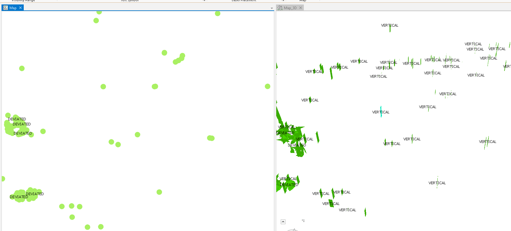

I am trying to add labels to my linear feature class. Some of my lines are vertical (i.e. I only see a point representing the start or end node of the line, because they have the same XY coordinates but different Z coordinates).
Unfortunately, it seems ArcMap cannot understand where to place the label (e.g. along the line, before the start, etc.) because the line itself is null (i.e. has 0 (zero) shape length).
Is there a way to solve this?
P.S. I am choosing a "random" Place because it seems there's no "ArcGIS Desktop" to choose... At least the same seems to happen in ArcGIS Pro in the 2d (not 3d) as well (see below).

Surprisingly, at a scale of 1:0 I can see the label
