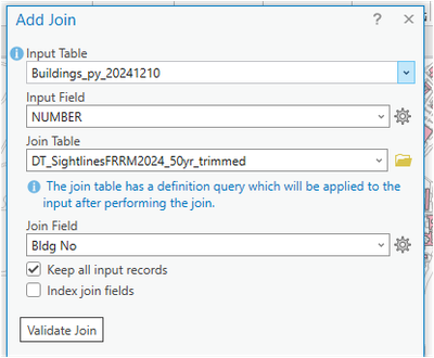

Hello all, Iʻm sure this worked on ArcMap but why is ArcGIS Pro not letting me? I basically am joining 2 tables via Building Number:
  • Buildings Layer
  • Subsystems Backlog standalone table

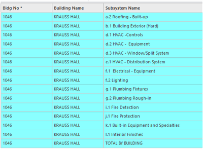

As you can see this is a One-to-Many relationship. My end goal is to create choropleth maps for each subsytem. My workflow in ArcMap was

I am trying to do this process in ArcGIS Pro but when joining, it tells me that "The join table has a definition query which will be applied to the input after performing the join." This results in a blank map as my Buildings layer now has a definition query applied to it. Removing that definition query lets me see my Buildings again but it basically joins it to the first record in my standalone table for that building:
This is essentially the same results as:
  1. Join Buildings layer with Standalone table
  2. Set a Definition Query for the subsystem
But this will only join with the first record, and I wouldn't be able to export the view I need!
I need to be able to filter the standalone table BEFORE joining my Buildings layer. It seems ArcGIS Pro is not letting me do that. Am I stuck with having to create separate standalone tables for each subsystem??

BarryNorthey
Make sure that the standalone table is in the same fGDB as the feature class.
JuliusP
Thanks for the reply Barry. I just tried that and I am still having the same issue of a blank map.
I ended up using ArcMap, which worked perfectly even if the feature class and the standalone table are in different fGDBʻs.  Itʻs equivalency issues like this that makes it difficult to fully transition to Pro
BarryNorthey
I forgot to mention that you must pick the Join Operation you want in the Add Join dialog when doing a 1-M join. Joining to a table that is outside the fGDB only gives the Join one to first option. The Join Table table must also have an OBJECTID type field. This gets added if a table such as a csv with no OBJECTID field is exported to the fGDB.

BarryNorthey
I am using 3.4 and it looks like things have changed since 3.2. As previously noted, make sure that both tables have an OBJECTID type field and are in the same fGDB. I recommend pressing the Validate Join button after making a join to verify that you got a 1-M join.
