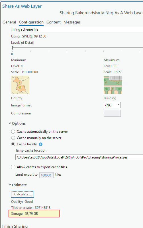

I am trying to make a cached tiled background map service on ArcGIS Online.
When I calculate size it says 59Gb, I have 550Gb free space on the harddrive but it still warns that the disk space will probably exceed available disk space. Then when i try to publish I get the error below - failed to publish web layer. Any ideas?
Bakgrundskarta Färg 2 89 WebTileLayer https://www.arcgis.com/ 2024-12-11 15:09:42 Status: InProgress StatusMessage: Publishing process started
Bakgrundskarta Färg 2 89 WebTileLayer https://www.arcgis.com/ 2024-12-11 15:09:42 Status: InProgress StatusMessage: Creating multipart tile package locally
Bakgrundskarta Färg 2 89 WebTileLayer https://www.arcgis.com/ 2024-12-11 15:09:45 Status: InProgress StatusMessage: Loaded SDE Workspaces
Bakgrundskarta Färg 2 89 WebTileLayer https://www.arcgis.com/ 2024-12-11 15:10:14 Status: InProgress StatusMessage: Failed to create tile package
Bakgrundskarta Färg 2 89 WebTileLayer https://www.arcgis.com/ 2024-12-11 15:10:16 Status: Failed ErrorMessage: Failed to publish web layer
