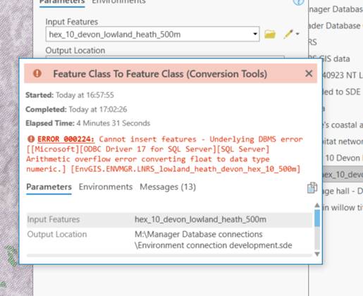

Hi all,
I have never had this issue before but recently two new layers that I have been trying to load to a database have thrown this error using Pro. These same layers will load to the same database without any problems using ArcMap.
Can anyone tell me why this is happening?
Thanks
Dave

Hey @davidchamberlain2
Do the data types assigned to each field match the database schema you're trying to upload to? If there is a decimal value you're uploading, you may need to check the precision of the field to be sure it's compensating for everything needed past the decimal point.
Otherwise, you may need to attempt to insert a single row, to test if it is a data type issue, or a data value issue within the row itself.
