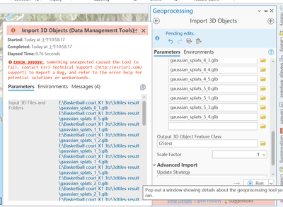

Hi Support,
We received an XGrids GSplat model in GLD format, but we cannot import the model into Pro using the 3D Objects GPTool.
I have upload the 3dtile in GLD format in this share link.
3dtiles-result

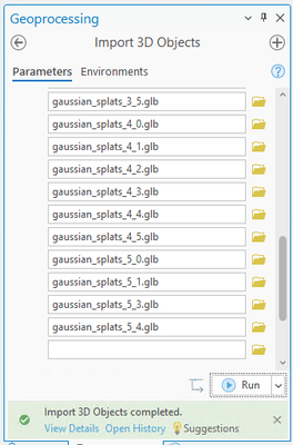

Hello @KevinChan331  , your data seems to import without an error for me. Are you using ArcGIS Pro 3.7.1 ?
KevinChan331
Hi @ChrisUnderwood , I have just upgraded ArcGIS Pro to the latest version 3.7.1, and the data seems to have imported successfully. Thanks a lot. In addition, would you please also advise how can I move and see the model in ArcGIS Pro. I am located in Hong Kong region.
