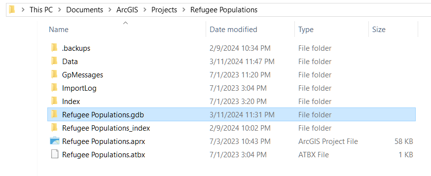

Hi Millie,
What I do with tutorial data folders is I download the zipfile to my download folder. Then I "extract all" on the download folder.  This creates a folder which is either a data folder or a project folder (which includes the .aprx project file you click on to open ArcGIS Pro).
In the example below I copy the "Data" folder and paste it inside an existing Arc GIS project folder ("Data" inside "Refugee Populations") or I paste the project folder "Refugee Populations" into Documents>ArcGIS>Projects.
Let us know how you did.
