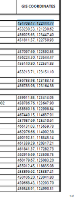

Anyone recognize these coordinates?
We took over a job and they didn't seem too happy with giving it over to use. We were given the bare minimum, and they don't want to cooperate.
They are supposed to be in Spring Grove, MN.
They look vaguely like Northing & Easting coordinates in the NAD1983 State Plane system.
We use WKID 2239 here in the southeast US, and they look very similar.
They just sent over screenshots and reports. Those were coordinates to wells in the area. So I looked them up on the CWI and was given these UTM coordinates. These are the top four from that previous list in the same order. The problem is that list contains about 20 private wells not listed on the CWI. We are trying to find their locations for monitoring.
