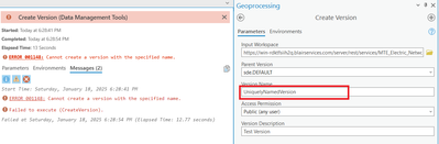

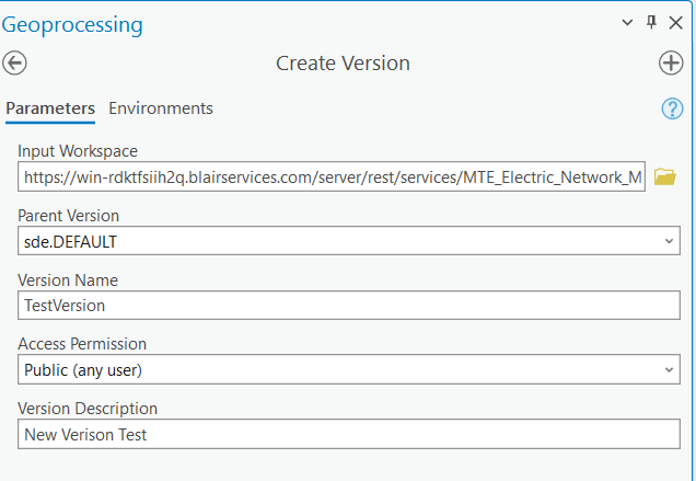

OK.  I'm stumped.   I've got a branch versioned feature service from which I'm trying to create a new version as a child of SDE.Default.   Here's are the GP tool parameters:
and here is the error
there is no other version of this name in this database.   I don't know if there is an issue with the name provided ('TestVersion') or something else.

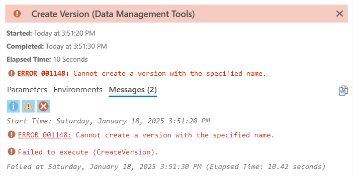

On the off chance that there might be another "TestVersion" lurking somewhere unseen in my database, I tried again with a version name I sure does not exist.   Same result:

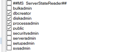

Thanks much for the suggestion.   I've considered this as well and I thought I had my bases covered, but maybe not.   I'm using SQL*Server.  Here are the permissions granted to my editor user:
- Server Roles:
- The schema containing the UN data is named GISADMIN.   I've granted my editor user SELECT, INSERT, UPDATE and DELETE on this schema.  Out of desperation I granted the same to the SDE schema.
- Also the editor user has the Enterprise user type "Creator"
If I'm missing something I would greatly appreciate any pointers.
