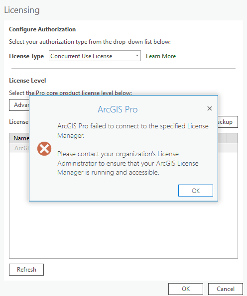

I am installing a concurrent user to Arc GIS Pro 2.9 and Arc GIS desktop 10.8.
I am receiving the following error.
My License Manager is working fine as other users are able to connect and use the ARC GIS.
Grateful if someone can help me
Thanks

There's not much information to work with.  That said, I would consider the following:
1.  Verify that your license manager has both Pro and Desktop licenses.  Each application has its own set of licenses.  Pro licenses cannot work for Desktop and vice versa.
2.  Verify you have Pro pointing to the correct license manager.  Check your other system that is working and make sure the hostname for the license manager is identical.
3.  Check communication.  Make sure you can ping the license manager from the Pro machine.  Ping the name you provided in Pro when trying to consume the concurrent use license.
4.  Check the firewall.  If there is communication between the two systems and other machines can use the licenses from the same license manager, there must be something blocking the ports used.  Start with the Windows firewall on the machine.  Disable it if it's enabled.  If it has to be on, check our documentation on how to configure the license manager through a firewall.
StatisticsMauritius
Hello,
Please see my comments in block letters below.
Grateful if you may further help. Thanks
1.  Verify that your license manager has both Pro and Desktop licenses.  Each application has its own set of licenses.  Pro licenses cannot work for Desktop and vice versa.  YES.
2.  Verify you have Pro pointing to the correct license manager.  Check your other system that is working and make sure the hostname for the license manager is identical.  . YES ALL OTHER LAPTOPS HAVE SAME CONFIGURATION AND HOSTNAME
3.  Check communication.  Make sure you can ping the license manager from the Pro machine.  Ping the name you provided in Pro when trying to consume the concurrent use license.  YES. I AM ABLE TO PING THE SERVER
4.  Check the firewall.  If there is communication between the two systems and other machines can use the licenses from the same license manager, there must be something blocking the ports used.  Start with the Windows firewall on the machine.  Disable it if it's enabled.  If it has to be on, check our documentation on how to configure the license manager through a firewall. .. THE LAPTOP HAS THE SAME CONFIGURATION AS THE OTHER PCS..

JoyMiles
