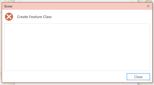

I have tried this a couple of times and keep running into the same issue. Here are the steps:
1) Create a new project (using NAS folder)
2) create new feature class in project geodatabase
This is year I get a big red error box. When you close that you get a second message saying cannot acquire lock. Images attached.
