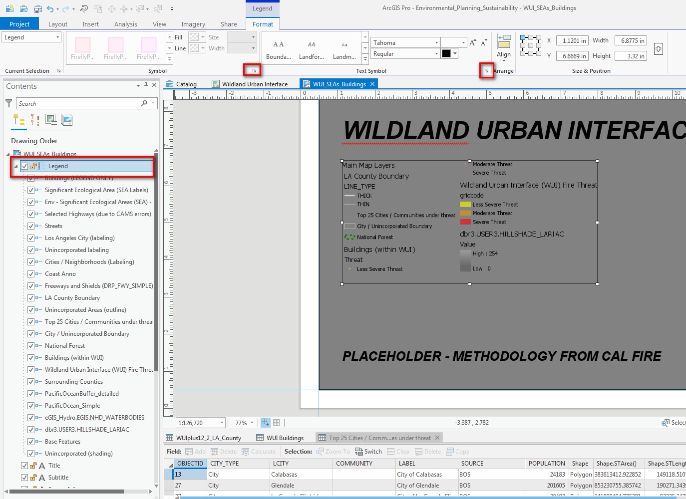

Hello,
I am unable to access the properties of a legend after importing an ArcMap (10.5) layout into a Pro (2.3.2) layout.  I deleted the old legend associated with the ArcMap Document and added a brand new one.  I can see my layers but when I right-click to access the properties nothing comes up.  I can only edit the formatting (even with that, I can't access any further functions for Text Symbol or Symbol by clicking the arrow on the bottom-right).  I'm assuming this may be due to the fact that it was imported from ArcMap....seems like buggy behavior.

DanHoffman1
Just got off the phone with ESRI Tech Support and confirmed that it was my ESRI Profile that got corrupted somehow (which can happen if you abruptly end a task, among other things).  The solution was to close all ArcGIS Pro and ArcMap documents, rename the 'ESRI' folder under C:\Users\<user name>\AppData\Local & Roaming to 'ESRI_old'.  After that, open ArcGIS Pro and it will create new ESRI Profile folders (you will just need to re-set your connections, template, etc.).  After that it worked just fine.  So, I'm marking this as answered.

DanHoffman1
Hi Tom,
Yes, I tried importing an MXD into another project and getting the same results.  I actually tried to access the legend properties on a non-MXD imported layout and I'm getting that behavior as well.
I think a tech support call may be in order as it looks to be a bigger problem than I thought.  Thanks!
