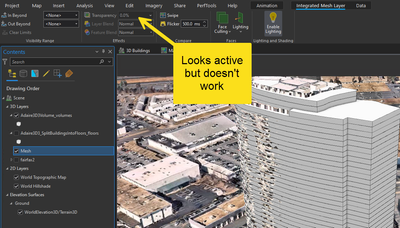

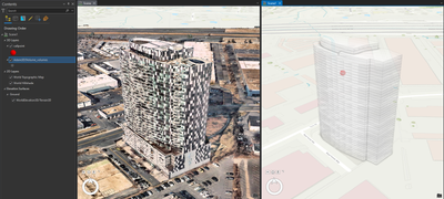

I'm looking at 3D mesh with building mass models I've created and can't set transparency on the mesh. Am I able to this if I change a setting somewhere else in Pro?
Robert_LeClair
Esri Esteemed Contributor
@GBacon - everything I'm reading says that you cannot set an transparency level for an Integrated Mesh Layer in ArcGIS Pro.  I'm working with an IML from ArcGIS Online and cannot find a way to set any transparencies.
GBacon
Thanks. I just checked a web scene as well and found the same thing. The clip and mask tools may be the best I can do. I'm looking into this because we're getting close to having z-values in emergency call locations and I don't want the mesh to obscure the point location inside a building. Point symbology or mass models with floors might be the best solution.
