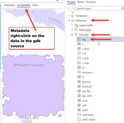

Hey,
I can't see the spatial information in my metadata. I load the layers and define the projection. When I go to see the metadata there is nothing there. What I did was change the metadata styles (have tried all of them now), and I did get more information but only for one of the layers. But still no spatial information.
Can anyone help? Have googled and asked my teacher but alas, no solution.

I access it through catalog in the geodatabase as shown in this example
Doing it on a layer in the TOC is limited

Thank you, Dan the man! It worked now for that one layer. Have problems with the other three layers but simply have to try and fix those in one way or another.
