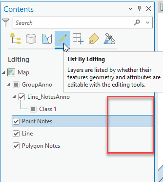

Scott_Harris
Is anything showing in the List By Editing view of the Contents pane? Warnings, errors (they would show up in the area I boxed out in red below)?
