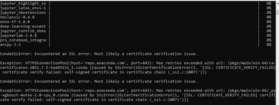

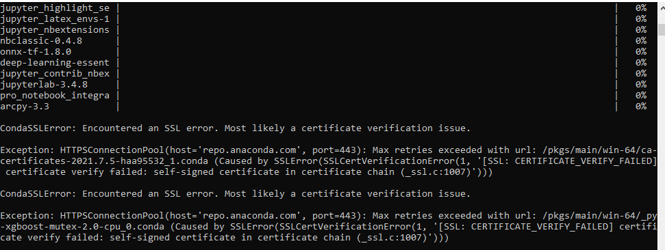

I am utilising ArcGIS pro 3.3.2 and I am unable to clone the default python environment. With previous versions of Pro, I tended to pip install into the default arcgispro-py3 location but that doesn't seem to work anymore so I attempted to clone the default environment. However, that errors out with the SSL error below.
Things that I have tried:
- Run as administrator
- set the security certificate using conda
- allow full control by users on the ArcGIS folder

This looks to be caused by a Self Signed SSL certificate. I have encountered something similar and I believe I cleared the ssl certificate cache and then I was able to proceed.
There are some solutions where you set verify to false to skip the check however I can't recommend this due to security issues. I hope this helps!
