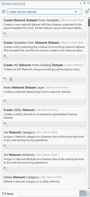

Hi guys,
I am trying to create a network dataset in ArcGIS Pro 2.3. When I search for "Create Network Dataset" tool, it does not appears.
Any support is appreciated.
Kind Regards
NikolasDingus
Hi @TugbaD
The ability to create a new Network Dataset was added in ArcGIS Pro 2.5. If you update Pro to at least that version, you should be able to create a new Network Dataset with the geoprocessing tool you mentioned.
Let me know if you have any questions!
Regards,
Nikolas
TugbaD
Thank you so much @NikolasDingus. I will try to create network dataset by using ArcMap.
