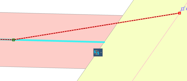

I am trying to do some feature editing in ArcGIS Pro 2.4.2 of lines and polygons. When I edit the line vertices the edits are not visible until I hit the save button and change extent. Same is happening while I am editing a polygon. If I reshape the polygon, I do not see the "reshaped" geometry until I hit the save button. This is very scary to do since there is know undo. This workflow of edit, save, change extent is not conducive to performing the task of feature editing in Pro. Are there some setting's that are not default that can help with this?
While editing and the feature is selected, the location of the edit is visible
After edit is complete and the selection is cleared and prior to pressing save, the edit is not visible.

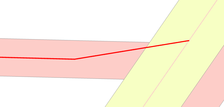

This same view is what is seen after pressing the save button and prior to changing extent.
The edit is visible only after the save button is pressed AND the visible extent is changed.
