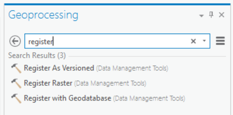

One thing before I close this out.  Is it possible to register the layer with the geodatabase and register as versioned using a tool in ArcGIS pro?  Maybe in a python script or ArcToolBox?
AdamZiegler1
Hi Jamie - Yes, both tools are available as GP tools, which means they are also available to use in Python scripting (links provide coding examples).
Register As Versioned—Data Management toolbox | ArcGIS Desktop
Register with Geodatabase—Data Management toolbox | ArcGIS Desktop
