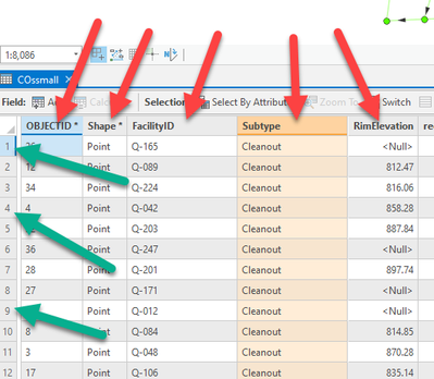

Add Field is exactly what you are asking.
Red = Field (aka Column)
Green = Data (aka Row )

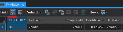

Thanks for the help! I just want to know, is there a specific button to press to add the new column? I am never given the option to create a new column when I press to add a new field or literally check anywhere at all on my attribute table

"Field" and "column" are the same thing. "Column" is more often used in purely table based applications, like Excel. "Field" is often used in database applications. Both mean "the vertical sections of a table".
